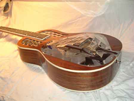

I have built a few over the years, a friend and I built a metal Dobro in 1989 he done the metal and I made the neck and put it together. I built a wooden single cone national ,after much difficulty I made the metal cover plate. The latest is a all Walnunt "tricone" it has a maple neck that runs through the body.

Bob, there are two basic styles of reso guitars, the National and the Dobro, although they were designed by the same guys the Dopyera brothers. The National which is what I built is the simplest I think to build and to set up. It just has a resonator cone that sits in a well and the strings ride across a biscuit that has a saddle on top making the cone vibrate to produce sound.
The Dobro also has a cone but the bridge sits on a spidery afair that I'm not real familiar with. Anyway the Dobro is perhaps a little more musical than the National style but if your lookin for that authentic slide blues sound then then National is the one. If I can give you any assistance I certainly will.John How38433.3682638889

Rigidity is the key I think. Think of the box as more of a guitar shaped speaker box. I made mine out of high quality 1/8 baltic birch plywood and then laminated it with the wood I wanted to use. It's still lighter than a metal resonator. I laminated a ring that hangs from the top down inside the guitar that the cone sits in. Most national reso's have a neck rood that goes all the way thru to the tail block but since mine is so rigid it just bolts on like any other bolt on neck. It works great. I like the sound of a wooden national better because it doesn't sound so much like a train wreck as the metal ones tend to (especially when I play them). Actully I think the Dobros sound a little better musically but I really don't know that much about them.

I agree with John about the body being rigid ,I also think the bar going through the body helps the volume .
The sound well on my single cones are made of very thin steel ,with the cone sitting in this . the sound well is fixed to the bar running through body again adding rigidiy.
The sound well on the Tricone is a bit of a compromise;
the well is made of laminated maple with the bottom being brass. The Tricone was a lot more work than the single cones,the sound with the walnut is a lot warmer and being 3 cones there seems to be more sustain.
